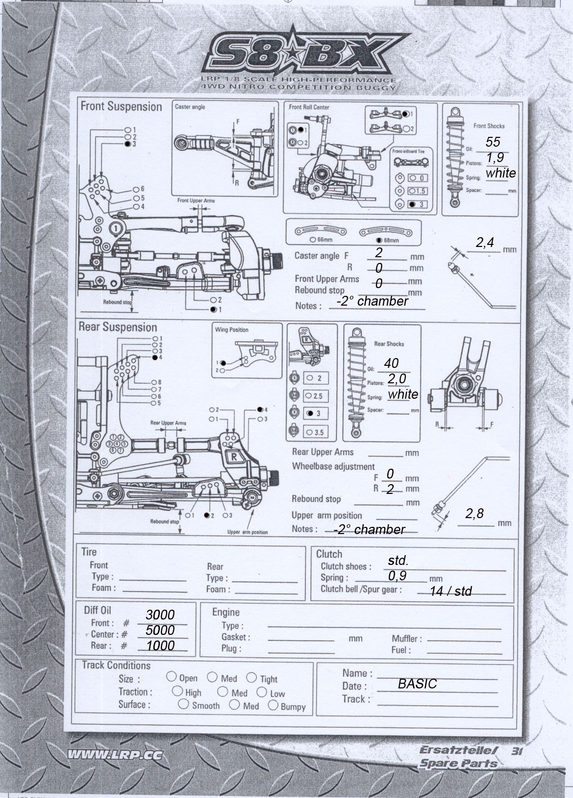

hi,
sorry i don't know if any other bodies will fit.
attached you will find my basic setup sheet.
